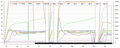

Testing a JB4 mobile firmware update now to address the root issue, but post up a full throttle log and lets see how your JB4 side data looks currently.
I sent a log via email all I have is my phone and I am struggling to get the file to load so I can post it here
Email is fine. We can pick it up there.
Cool I just sent it it's Rob's GT, the support for the jb4 is the best I've seen, any tuning advice would be welcome as well, all my mods are in the email I believe, do you think the Big Bore throttle body is actually any help?
Seems OK. Part of the log is map1, part is map2. And in some cases you're not at full throttle which would reduce target.
Yea I switch to map2 in log. No much KR in map2. Is safe ?
I will try octane booster in 91 oct fuel if map2 make too much KR
Map2 isn't ideal but it's probably faster than map1. I don't think it's going to blow up but more octane would help map2 performance.

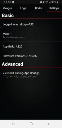

Do you have anything new about the wrong data of the jb4 mobile adapter
Will post an update when we have it on that.
Hm I think that I see another data loss in this log
Yes looks the same, it updated firmware on the adapter? I'll let Donnie know to keep working on it!
Yes. Update v320 and update when i connect bluethoot on v3.7
