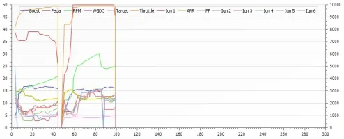

I see some timing drops here on the start of the first run. If it's a trend and doesn't adapt out then might make sense to drop down in boost in that range with a custom map6.

Low fuel quality ? Low octane ?
Next time i will change gas station for shell 91 for try
Right low fuel quality
The 91 Shell V power is what I had to change to because of the unstable gas , And so far here in Kelowna BC it seems to be the best gas ⛽️ for tuned cars of 91 octane tune :)

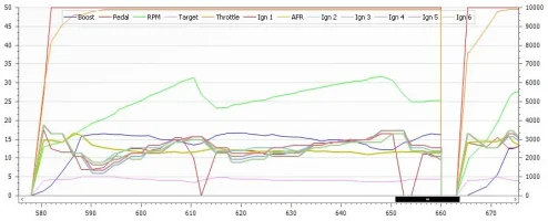

Log SHELL 91 v power with 250 mL octane booster.
Mid throttle ar low rpm. Not ear "tic" noise with v-power shell
Timing looks good as far as I can tell here.

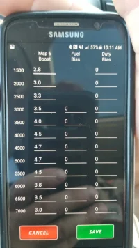

Map6 custom for not ear tic noise at low rpm ??? Looking good for you ?

Yes looks fine to me if it's getting the job done!

I dont anderstand why sometime i ear one or two tic noise when i push accelerator at low rpm and high rpm i have good timing. Bad plug ? But only 1000 mile.
Map 0 no noise
Map1 and map2 tic sound only at low rpm on boost. On high rpm no problem.
Don't know but I can see timing isn't perfect, so likely a boost or octane issue. Did you up the octane to see if it goes away as a test?
I added another brand of octane booster since I heard this noise (hy-per fuel) bad octane booster maybe
If more octane doesn't stop it then it's not knock related.
