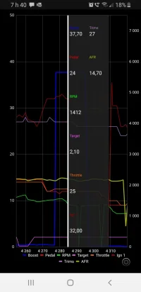

Another question about log. Is it normal that i see false peaks since boost signal. Check this picture
False Peak boost

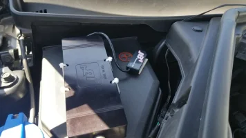

Looks like an app issue or signal strength issue on the blue tooth adapter, photo of how it's located in the engine bay?
I have a suspicion this fault might be related to an issue with the JB4 mobile adapters themselves. Photo of your adapter and where it's located in the engine bay?
Here is the pic. So i drove today for 45min This is what happened. No code so thats good. I started on map 2 (turned off my car previously on this). It stayed on map 2 for about 15min. After that it suddenly without me doing anything changed to Map 1 and stayed on Map 1
I've also uploaded an auto log (did not start it myself) of i think when it switched (doesnt show the change in the log.
One more thing i'll note that i forgot to previously mention. The main connector on the jb4 harness side did not have ANY screws securing it to the board. It came with 2 loose screws for the BT adapter only. So i am missing 2 screws on the main connector side.

As a test try removing the black shell on the JB4 mobile adapter that attaches to the JB4 board, I wonder if that might be preventing a solid connection to the adapter.

It's an evolving issue so we're trying to figure out if all of the new JB4 mobile adapters are physically faulty, if there is a firmware issue with them, or if there is some other issue like the connector not allowing a proper fit to the JB4 control board.
Meanwhile I'm working on firmware v15.1 I'll post later for you guys to test trying to patch the issue on the JB4 side.
