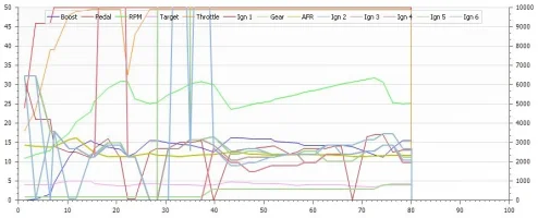

I drove for 2 hours without problem.
only some missed logging data
Check log. Some WOT. Map1 91 octane. Can you check for knock in same time ?
Looks good! Map2 next.

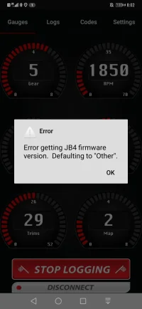

But I received it on Tuesday the 21st from PROspec Automotive.
Ok nice !OK thanks! Donnie is hard at work on the data corruption issue so we'll update you on that front when we have it. Hopefully it's something we can fix via a firmware update rather than having to swap the JB4 mobile adapter but we'll know more soon.
OK. I will test in the next few daysYes WOT, to evaluate. If it's ugly then I'll say go back to 91.![]()

Ok Terry.Yes WOT, to evaluate. If it's ugly then I'll say go back to 91.![]()
Where you see timing drop. Ign1, ign2,ign3.... ?Quite a few timing drops especially in 3rd, you might be best off with map1.
The engine code? or my screenshot?Just an FYI I get that same code at least once or twice a day when I use mine as well with this new install last weekend ,firmware to the newest 16
