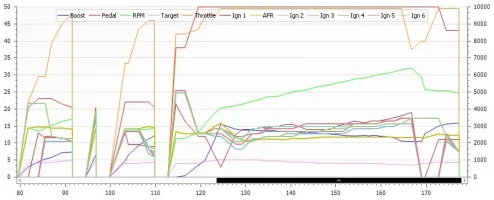

Hi Terry
Currently Running Map 2 94 octane
Intake BMS, Denso 1 step, fuel wire connected. Is everything ok ?
So is that CDN Chevron 94?Hi Terry

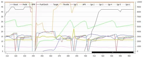

Another log v325. Small log map2 91 octane with octane booster. Check for knock in same time please heheLog looks better to me, have a longer one?
bluetooth connection problem seems solved !Looks normal for map2 91 octane.
In this new log...map2Looks normal for map2 91 octane.
