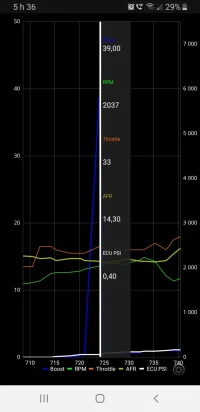

I recorded a log with v16. about 15 minutes.
I saw a false boost peak
Some garbage logging data coming in is one issue. I'm more concerned with fault code and map switching at the moment.

Ok. But some garbage logging data is only with specifically related to the new batch of BT with the black shell and black wires ?? Or all version
New version, we're still sorting out why. Seems to only be happening on a few cars. The changes I'm working on right now on the firmware side are to protect the JB4 against garbage bluetooth data switching maps, settings, or triggering fault codes.
