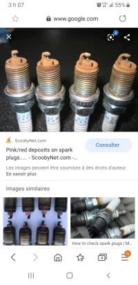

Yes , and I believe most of higher quality booster s are made with certain amount MMT ,and is a fuel stabilizer as well but is hard on plugs lol
my spark plugs already look like the ones in the photo
Yes just like that picture and it burns the tip faster but sometimes there is a trade off for that thing called performance lol

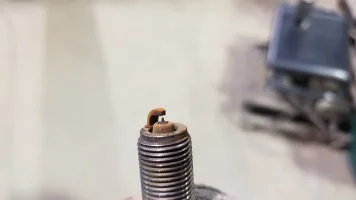

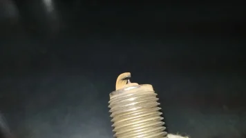

My spark plug on cylinder 4
Looks almost identical to my Denso with 12 k on them before , I went to a NGK 2 degrees colder #9 race plugs and , those came with .28 pre gapped , now I have almost 28k on my Stinger GT and recently had the shop check the plugs out and , they were still very good :) :) !!!!
Looks almost identical to my Denso with 12 k on them before , I went to a NGK 2 degrees colder #9 race plugs and , those came with .28 pre gapped , now I have almost 28k on my Stinger GT and recently had the shop check the plugs to out and still very good :) :)

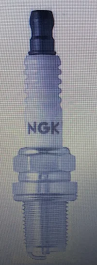

Number part ?
Number part ?
NGK 4654 Model #R7437-9 the bottom electro is thick , just like the picture I have following here :) but they are approximately $60.00 each plug Canadian , 360.00 plus install ! They are pre gapped at .028 , so I left them at this and no even at -20 to start up ! Denso 2 degrees colder run at approximately $60.00 Us for the 6 plugs :)

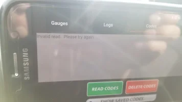

Looks like some sort of bug, if that appears with ign fully on when reading codes.
