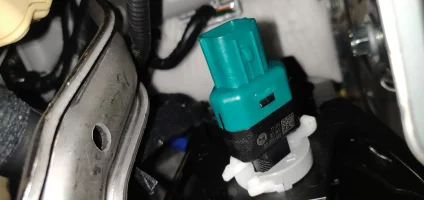

It's possible to get to the brake signal wire from somewhere else. In fact, I've been trying to find a source for a specific connector (both male and female) so that I could make a plug n play extension harness, similar to that of the o2 sensor extension harnesses used in the JB4.
So far, the connector suppliers I've found are VERY expensive. As in, it would cost me around $250 to build ONE harness. It would be a really good harness with its own lighted switch, but still, too expensive.
Edit: Found another supplier, but they have a 500 unit minimum. And I don't want to make that big of a commitment, nor do I think the interest is that big in a product like this. I'll keep looking, but with all the dead ends I've been seeing I am doubtful that I'll be able to get this going the way I want to.
Todda.....so where is the alternate spot for the snip? Wash

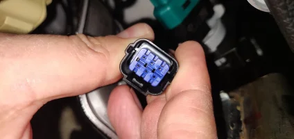

It's on the brake pedal harness. You can see the green wire on the 6 pin harness connector...
I've been trying to find a connector supplier so I could fabricate some pnp harnesses, but it looks like Terry might have beat me to it.
ALLRIGHT Toddas ! now we are getting somewhere...thanks ! if i could find the brake pedal harness ....lol
way to go! :thumbup: Wash

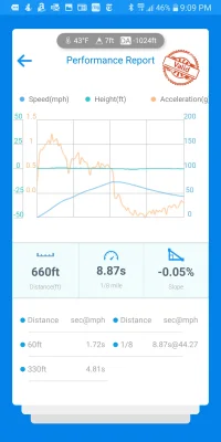

Getting closer in the ecu flash 1.72 isnt bad and is better than my snip 60s.
Not as good as those few top snip 60s but as good or better than most.
3 to 3.5 psi 2450 rpm
