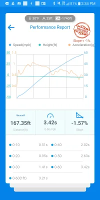

Stage 2 tork tune launch is already as fast as the majority of snip launches, the slower pack of snippers around 1.75 60s, and more importantly the throttle opens faster than the normal snip mode ( no flashing A) so you are even faster to 60 mph than 60 foot than snip.
