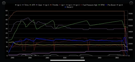

Why do you want to run lower AFR than 12 like it seem to be in log? Gdi engines will make most power at 12,5:1 so 12 seems very right if you run Meth or E85
Some spikes after gear change seems to be at 13.1 and as high as 13.4 like 2-3 and occasionally 3-4. Just wanted to make them below 13 all the time. If it doesn’t matter that much then I’m not bothering

JB4 Map4 with SXTH BEF. Gear shift timing revised. The car is smooth. Need bigger nozzle for real.9E02DA60-6C92-4594-8281-3C10861567D0.png
