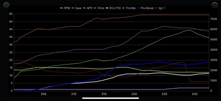

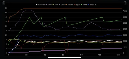

Compare your log with mine. You can probably see how much slower I build the boost.IMG_6879.png
Also here is Lozic 1.5. You can see how much faster the boost creeps up comparing with JB4 without EWG.
The crazy thing is a slow JB4 launch like that is not even any slower than my lozic 1.5, big power coming from timing for sure.
Compare your log with mine. You can probably see how much slower I build the boost.View attachment 79470

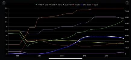

Here’s mine
Definitely a difference in timing

Here’s mine
Your 1st and 2nd gear have more boost while boost builds faster too. I guess EWG is 100 needed for me.
