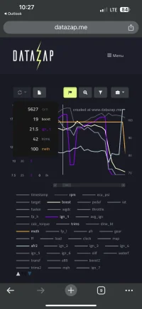

here is a log with 2 different BEF's

Are you still using the old 21 deg bef?

Are you sure? I see ignition timing hittting 21
I was under the impression it was the 19 one.
it is the one that was labeled JB4 RACE IGN BEF_CENNDM_U_N2B
Your deff on the old 21 deg flash as its hitting 21 deg peak every time and it has no shift timing. Id email terry and send him that same log. Have him send you an actaul race bef or e85 bef. Race is only supposed to hit 17 deg & e85 19 deg
