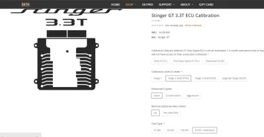

Info for SXTH stage 2 flat boost. the $399 for 1700 credit is not enough to cover the cost of this tune since it costs me 2100 credits. Revision might just need extra credits but considering mine current peaks at 22 psi, I might want to dail it back with a revision if JB4 map8 shaves off too much boost.

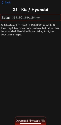

I believe the JB4 allows you to also dial it down on map 6 you can use it to remove psi.
I have been using JB4/cpi and try to hit 20-21 psi . depends on weather conditions elevation etc.. it’s different for everyone.JB4 rev28.webp

I’ll update to this firmware for sure. 2 psi off can definitely give me extra timing considering I’m using pump gas 93 + 80/20 meth. Also I have no idea if revisions are extra or not. It might depends on if you’re looking for a custom setting based on a current map or your tune is not performing well. I think most tuners will cover the second scenario.

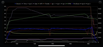

Here is the update you guys looking for. This the the backend flash and the boost is controlled by JB4. Apparently 600cc nozzle is not enough for this amount of timing and boost. A new revision with richer afr and ECU 0.4 bar launch+disable TCU launch should be coming soon. Unfortunately my cat is clogged by Lozic bubble tune(code disabled with his tune so I have no idea when does that happened until I switched to sxth). I’m having hard time adding boost with JB4(map5 peak at 18-17psi after gear change should be an obvious evidence).Luckily it’s just clogged with carbon buildup and it’s cleanable with off the shelf cat cleaners or even just xylene. I’m currently running -2 psi across the map than yesterday while having 2 psi higher boost. It should be clear that those cleaners are working it’s magic.
