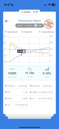

Did a1/4 pull today with a slow launch(2-3 psi). Road is too dusty from melted snow so I didn’t try launch any harder. Seems like mid 11s is guaranteed with a proper launch.10A7D7E0-25EF-4A4E-8555-FC4A1B41003A.png

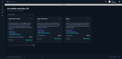

I saw a Stage 2 91/93 Octane 470whp/490wtq for $450 on the SxthNk tuning site that was posted a couple days ago. Sxth also has a Stage 2 back-end flash for piggybacks that disables ISG and increases timing.
I saw a Stage 2 91/93 Octane 470whp/490wtq for $450 on the SxthNk tuning site that was posted a couple days ago. Sxth also has a Stage 2 back-end flash for piggybacks that disables ISG (Idle Stop and Go) and increases timing.

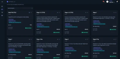

how do you see the Stage 2 back-end flash? I'm only seeing the Stage 2 91/93

It's on the last page
thats why.
my calibration ID is CENNDM_U_N2B. Yours is different which is why I don't see those

you are logged in as a guest user which shows everything.

makes sense. I'm guessing you can't mix and match them which is why it doesn't show in my account. Same for the TCU tunes.
