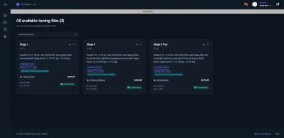

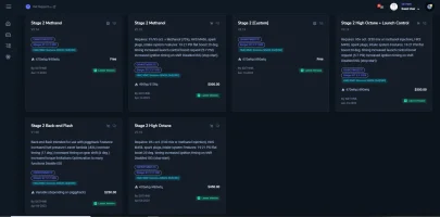

I still don't understand when you say Stage 2 requires E30 or methanol. I see a Stage 2 with 91 or 93 oct only and supporting mods and another tune called Stage 2 Methanol which requires meth. Am I missing something or just not understanding?
Back end flash as in their tunes on the site correct? And it seems they have ECU and TCU tunes. So then essentially JB4 would be for logging and find tuning said tune?
So you're not missing anything, but the way stage 2 is done is a little confusing, as the stage 2 tune without running an e-mix or WMI will not run the tune to its full potential. you certainly could do it, but it would very much depend on the quality of your pump gas.
Ahh so the extra 400 is for it being on a fancy tablet. Makes sense. So I could either pay for a tune from sxth and send it via the OBD port, or use in conjuction with JB4, utilize those maps and not pay sxth for a tune. Interesting.
Ok I think I got it. I can run Stage 2 tune on 93 but it will be a Stage 2 Lite. If I use the JB4 and mix some E30 in and refine boost i can make that Stage 2 Lite into like a Stage 2 Lite+. If I want full Stage 2 I'd need CPI or WMI?
If you are running the stage2 tune on pump gas alone, i would keep the JB4 in map 0 unless you decide you need to reduce boost, which you will figure out from your logs. The rest of what you said is correct, stage 2 does best on CPI or WMI.

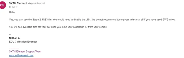

This is an email I got from Nathan when asking about Stage 2 91/93 tune and JB4. He recommends disabling it and not tuning if you have EWG wires installed. Now I'm really confused.
