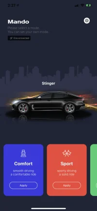

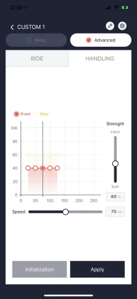

I'll answer it this way; it can be minor or major, because you get to make the changes. If you stick with the predetermined settings, Comfort and Sport, you will find that both make the car more settled and improves the ride and handling. If you are feeling adventurous, then jump over to the Custom settings, of which there are 4, and adjust to your heart's content. In the Custom area you have a choice of Basic or Advanced. Basic lets you choose to modify the Ride settings, front and rear, independently of the Handling settings, by use of simple sliders from soft to hard (0-100%).
Consider yourself a seasoned track tuner and want more adjustments? Pop on over into the Advanced section where you can also adjust the settings for different speeds!
This thing is not just an add on which only give you a simple adjustment of Comfort and Sport, it goes way beyond that and give you access to the full range of the shocks. I'll say this, I set it at 70% in the Basic section and it was a harsh ride. I can't see anyone using 100% setting on the streets for too long, that would be too much stress on the body and the car would also suffer. In my mind, this is a major upgrade! Your tuning options are wide open with this.

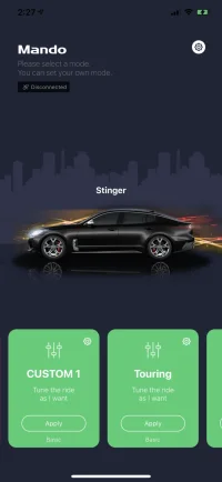

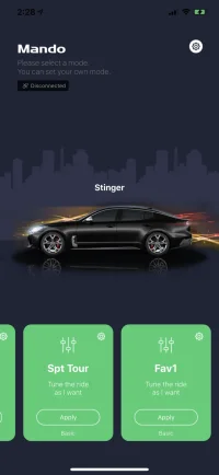

I changed the names of 3 of the Custom modes, Touring, Spt Tour and Fav1 are my settings. Fave one is the one I shared and I will be fine tuning the others and sharing them soon.
