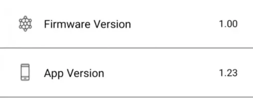

You can check your firmware version on the phone App. Mine is a very early version as well.
