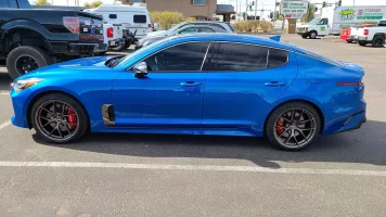

I picked up some ESR wheels this year. Fronts, 19x8.5 +30 Rears 19x9.5 +35 RF2 in Bronze. Tires are the stock Michelin Super Sports.

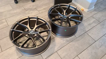

Mounted up my tires to my wheels from getyourwheels. TSW Neptunes in bronze. 18x8 +35 front with 245/45r18 and 18x9.5 +39 with 275/40r18 General GMax.
Slightly taller than stock tires. So far the ride quality is great and handling is way better than the stock a/s tires. Thinking about doing a slight drop later on. Also happy that TPMS self program on our cars.

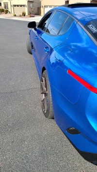

Terrible Picture but got my Stance SF03s on today
Not a bad pic. Looking at these for my setup. What are the measurements on wheels and tires?
