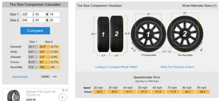

I did a wheel comparison on stock tire sizes and these and what is the tolerance for speedometer for actual speed at a certain mph.
You can have taller tire and within 3% is considered safe and will not affect car stability electronics but you will go 1-2 mph faster depending on your speed. Also 245/35 and 285/30 are exactly the same size and this is important (at least for AWD).
There are so many people running this tire setup you should not be worried.
