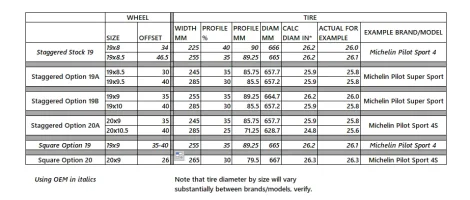

  1. Shrikecorp
    Shrikecorp United States Stinger Enthusiast Sustaining Member
    521
    194
    Location:
    Seattle, WA, USA
    I've been sort of compiling and validating some combinations. Criteria: avoiding poke, trying to find ways to improve on the stock look without compromising performance too much, etc. Seems like an okay start, might be cool if we could add to it (original in Excel has formulas and all that bit.) Thoughts?
    Corrected/updated:
    Link to editable Google Sheet. Add your own, etc. Play nice. Wheel Tire Options
    • Added columns for AWD/RWD and lowered or not.
    Seriously nifty comprehensive calculator linked by @YOWStinger : Rim & Tire Size Calculator. Custom Offsets

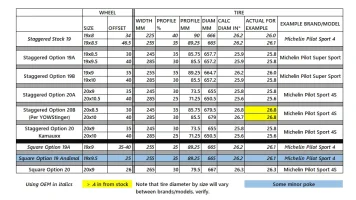

    If I may suggest, staggered 20 option B is
    Front 20x8.5+30 245/35r20
    Rear 20x10+40 285/30r20
    This is the suggested TSW wheel size, I'm still working on validating +40 in the front which may not work depending on the shape of the spoke.+40 was used on the Federation Stinger on the front with TSW Sprints.

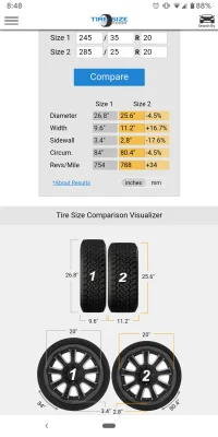

  7. Kamauxx
    4,536
    1,662
    20a wouldn't work. The rear tire would be way too small compared to the front. Since that looks like the specs from my car you probably meant to put 285/30 vice 285/25.
    A 285/25/20 mixed with 245/35/20 would look like this:
    • Like Like x 1
    • Agree Agree x 1

  9. Shrikecorp
    521
    194
    Location:
    Seattle, WA, USA
    Thanks! I see my formula for calc diameter for 20A was borked, now corrected in Excel file. And it now aligns with the results you got from the TireSize calculator. :D The mix I was going for was 245/30 20 and 285/25 20, trying to stay very close to stock diameter, which gets us this...just .2"/0.8% difference, pretty close to the stock 26 and 26.1:
    What's yours exactly, offsets and all?

  13. Tobstertx3
    Tobstertx3 United States Stinger Enthusiast Texas Stinger Swarm
    503
    175
    Location:
    Houston, TX
    Another option for you which is my current 20” staggered setup
    Front 20x9+35mm 235x35

  16. Shrikecorp
    521
    194
    Location:
    Seattle, WA, USA
    Here we go. Posting this here, and I'll add the original post. Link to Google Sheet, open to edit for all who have the link. Add yours if you like, etc. Play nice. Wheel Tire Options
