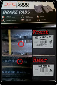

For performance - the friction coefficients (both cold and hot) are usually stamped right on the pads (edge code).
The OEM pads on the stinger are FG (both front and rear)
The Centric pads I installed are FF (both front and rear) - so slightly MORE pedal effort would be required for these aftermarket pads VS oem - when hot.
The first letter of the code represents the normal friction coefficient. This is defined as the average of four test data points measured at 200, 250, 300 and 400 degrees Farenheit.
The second letter is the hot friction coefficient is defined as the average of 10 data points located at 400 and 300F. On the first recovery cycle of the pad; 450, 500, 550, 600 and 650F. On the second fade cycle; and 500, 400, and 300F on the second recovery cycle.
Each code letter are as follows:
C = less than 0.15
D= 0.15 to 0.25
E= 0.25 to 0.35
F= 0.35 to 0.45
G= 0.45 to 0.55
H= over 0.55
