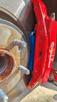

Has anyone tried the Advics Ceramics?
ADVICS AD2145 - Front
ADVICS AD2144 - Rear
I was trying to find the Posi-Quiet, just can't seem to find them in stock. Rock Auto has these Advics, looking for a good daily driver setup.

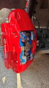

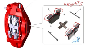

Also, I'm not quite understanding the Posi-Quiet rears, 105.60410, on the forums they say "weights" what is that? Looking online, I see things listed as shims, is that same thing?
I have not found any rear pads WITHOUT WEIGHTS that will fit.
For the front, any standard 1001 size pad will fit. 1001 pad size, is quite possibly the most common pad size. Massive compatibility.
I am currently using front pads without weights, no sounds or squeals whatsoever.
