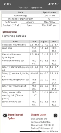

I just did mine till they felt right. Looking back, I probably should have used a torque wrench. Still have no issues so I guess I felt correctlyI’ve heard folks including John from Tork Motorsports mention the torque spec to be 20-24, but Kia recommends 11-18.
I would like to torque it in the middle range, however I read you can’t get a reliable reading off a torque wrench when using swivel sockets. Is this true? Someone mentioned they were able to use a torque wrench with a swivel socket. I’m concerned using a torque wrench may over tighten if it’s not getting an accurate reading.
For those folks that went hand tight on the plugs and then a 1/4 turn with a rachet did you feel the gasket squish (as you should) and have you had any issues since with your plugs? The ramifications from not tightening them enough is no bueno.
