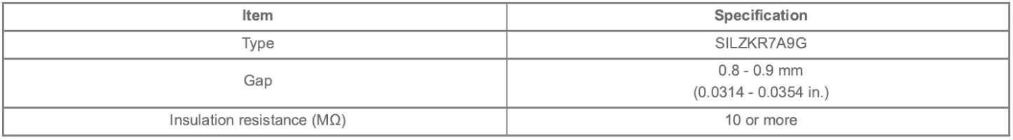

This is from the service manual for the 3.3L. I might go a little narrower but I don't think you need to go all the way to 0.024, stock.
