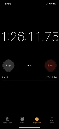

I read the entire thread a few times and watched the youtube videos. I decided today was the day. Changed out in just under 1.5 hours. The hardest part for me was loosening the center passenger side plug. I got the center passenger coil pack out in about 4 minutes - I was checking. I tried to rotate it 180degrees to remove through the front (as one of the comments mentioned) it but I could not figure it out, so I took it out through the back. When I replaced it I decide to insert 180degrees around through the front just to see if it was possible. Once I had it in the hole I was able to turn it around with no problem. That actually worked quite well. I completed the driver side plugs in 23min.
