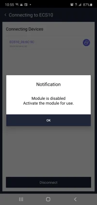

Installed it today and tried to boot it up...
No Luck
Any Ideas guys?
