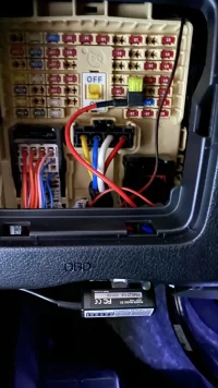

Here is the switched 20A I used (power port)
