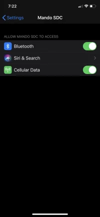

Anybody have any problems connecting to the Mando unit. I can not connect thought the app.
no issues here, maybe the device doesn’t have power?
Light is on, my phone sees the Mando unit, but the app doesn't connect
Hmm, bizarre, check your OS settings, it’s possible the Mando app doesn’t have permission to use Bluetooth

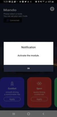

Got in my car this morning and the app is asking me to activate my Mando unit. The app says its connected but whenever I try to change settings it say to activate unit.
