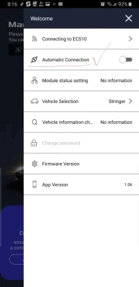

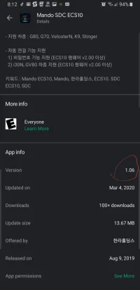

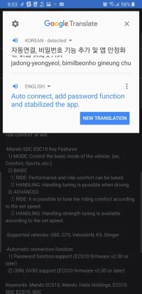

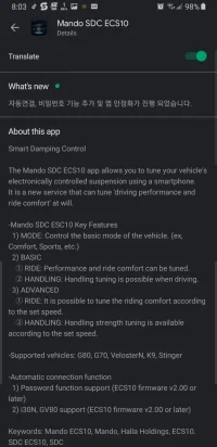

V1.06 is the first version that enabled the auto connect feature - released as a beta build on March 4th 2020I don't see this version being available for iphone. I do see 1.03. I am on 1.02. Does anyone know if this version enables autoconnect on iphone?

What is the new iOS version #?Well today the update for IOS came out and it auto connects. I am going to enjoy this more now that I know I have been missing the improved Mando setting due to thinking that the settings were persistent through restarts.

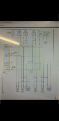

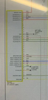

The electronic shocks on our cars do not possess the ability to adjust rebound damping. Only compression damping adjustment is possible.
There is only 1 solonoid valve per shock, and only 2 wires going from the ECS unit(OEM) to each shock solonoid (as seen in the attached schematic)
This allows for adjustment of compression damping only.
It is "possible" that the solonoid valve controls both the compression and rebound together, but then we would not have independent control over compression and rebound.
I know these images are poor quality. But hopefully you can read what I am describing in the OEM schematics attached.
Are those wiring diagrams from KGIS? Those are the first evidence I've seen that back up what some have thought regarding the Stinger's ECS system reacting to G-sensors, among others. Good find!
Not completely sure what to tell you about the compression and rebound adjustment. There are several possibilities for how the system was implemented, but changes to each of the types of adjustment absolutely do change compression and rebound, or something mimicking them. The changes that each can make map directly to how those parameters translate into objective ride and handling results and line-up with everything I've been able to find regarding suspension tuning and mechanics thus far.
Ty Davis posted info several months ago regarding this. He was reporting that his scanning tool was showing voltage changes while driving. Probably changing damping when acceleration, cornering and braking were detected.
