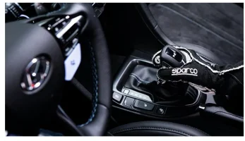

Changed non-electronic shifter knob to Hyundai one
Upgraded Carbon N Line shifter for those interested, from G4WERKZ. $225.00
You can customize, pictures are the one designed for me. Email me for more info, this is one time run, open for a few days. Delivery is around two weeks after group buy closes.

Has anyone posted a video on how to change the T handle to the N-line shifter? I just received my N-line shifter today & copied all your comments related to this but still a little confused. Or can anyone provide step-by-step instructions on how to replace the shifter.
this is that I purchased:
Shift knob: 46720G350RMW
Shift boot: 84632G3130RMW
thanks for your help!

This pretty much applies. Used photos from this post to make it.
1. Shift the gear to "N".
2. Remove the boot from the console upper cover by pulling upward along the inner edge. You can use plastic pry tools to help get it loose. I used my fingers I think on the leather side to pull up the frame.
3. Remove the knob by pulling the direction of arrow after
4) After that, it's about getting the clip off of the old knob that holds the boot to the knob and transferring the new knob's clip over to the original boot. You may need to use a little glue and or clip the boot to get it to fit properly.
20190814_225741-copy-large-jpg.29502
1f8e386b-f9c6-4f9f-9721-de708664d427-jpeg.30394
a455eec7-def9-4308-88a4-7cdc44b4d6e9-jpeg.31663
5) Once the new clip is in place, snap the new knob to the original boot.
b89ce60a-2b6f-4356-8cbe-bb626335ffd8-jpeg.31664
6) Take the boot and new knob and press it down the shifter shaft until it clicks. Test functionality.
7) Resnap back in the boot into the console upper cover.
8) Done.
