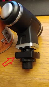

Most likely yes if you want to get the matching shift boot collar. This is a little plastic piece that holds up the shift boot to the shift knob. Without the collar, you would have to zip tie or find a way to tie the shift boot to the shift knob.
The shift boot collar is not a separate part. It only comes with the shift boot.
Looks like this.
