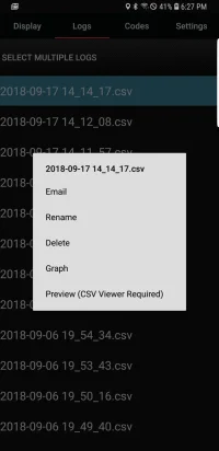

Oh you can also just posted it to the N54tech kia forum where we post the firmware, maps, and updates.
Email to yourself, attach to post. Or copy of phone directly when its plugged in.

I didn't but i will leave that to Terry to respond to. I had just switched to map 6 yesterday and made 3 pulls. Log files are on the N54 page.
