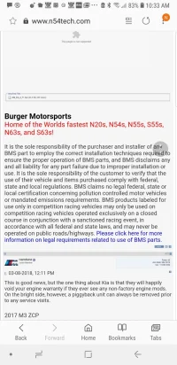

You dont see this on the first page? It's a .hex fileScreenshot_20180921-103329_Samsung Internet.webp
That’s the issue I’m having I can not find the firmware when it takes me to that site. I go into
The Kia section but I do not see a firmware download there.

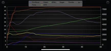

5F7EC7ED-DC7B-4BCA-8A59-8D791617223E.webp I tried out map 1 think I heard a bit of pre ignition but hard to tell. Map 2 definitely had some. I put in more 94 octane. I’m going to stick with make one as I might be a bit lean low down. Here’s a pull in 3rd on map 1. I have downpipes and k&n filters maybe that is the cause.
Is it hard to make the car run a bit richer?
Edit did another run with full tank of 94 on map one and when I floored it and it geared down still getting detonation. I’m at sea level and it’s 14 today. I guess I’m going to have to figure out how to send in some logs to fix up the tune. Or maybe not run the fuel wires.

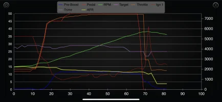

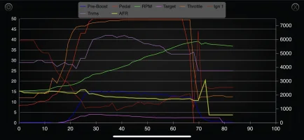

024A9248-442D-495D-9DBA-9B1FC6DE7C16.webp EC8B44FE-61A8-4886-A7E9-67B3505988D9.webp Does anyone have any know how to tune afr for map 1 and map 2? Is that fuel bias sections does that apply to map 1 and map 2? Having all these setting in this thing is awesome but it’s going to take a while to learn it all. I put the fuel bias back to all 0 Andy went for another drive.
The first picture is stock boost the the 2nd is map1. I did not hear any detonation this time.
