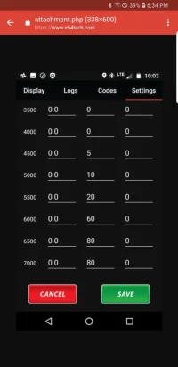

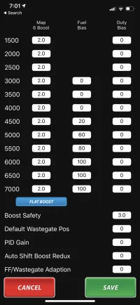

22CF5A48-DFD7-47BF-89AC-A41C68218672.webp Ok guys I got the chip installed and put in the fuel setting I saw. The car was boosting funny. After I hit the button flat boost its working great now. Do these setting look correct? And how do I know the fuel wires aren’t working? This is new to me so any tips to get started would be great. I put it on map 5 by mistake did not go full throttle but I have to watch my fingers.

you dont have to input any changes for maps 1 and 2. You should probably play around with those two maps first. Only on map 3 do you need to change fuel bias only. But that requires blended fuel e85 and high test.

Thanks, is there anyway to know if the fuel wires are working?
Check your logs for the AFR. Set your fuel settings as per Terry's directions as well. Map 5 i haven't made any changes and have let Terry review the logs.
View attachment 12725 Ok guys I got the chip installed and put in the fuel setting I saw. The car was boosting funny. After I hit the button flat boost its working great now. Do these setting look correct? And how do I know the fuel wires aren’t working? This is new to me so any tips to get started would be great. I put it on map 5 by mistake did not go full throttle but I have to watch my fingers.
Flatboost is for setting map6 boost values quickly. Fuel setting should match defaults in thread: Kia & Hyundai JB4 - N54Tech.com - International Turbo Racing Discussion
If you need tuning help then just record a JB4 log of what you want us to look at/help you with.

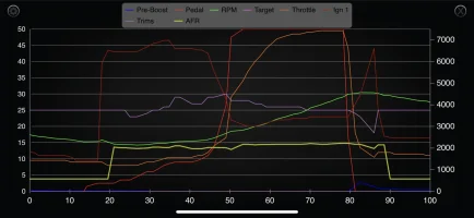

7C6F168A-66D8-47D9-851B-22E21E87F1EB.webp So I’ve had a issue twice now while using the low boost mode tune 4. It gone to 0% boost the turbos are making zero boost. Then I change to tune 0 and it’s still zero boost. After turning car off and on then I get normal boost. Is this just a issue with that mode 4? Here is a screen shot when I have no boost. I wonder if I have a defective tuner.
