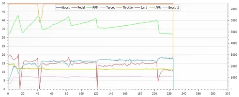

I just did two pulls on my way home, with map 8.
They are 2nd gear pulls @ ~37mph.
Could you please have a look at the logs?
Do you have any idea why the throttle closed two times in the 1st run. Is there any factor is causing this?
I also wonder why the ECU PSI is so low at the beginning (below 8psi), is it normal?
I've seen the car use more boost in other days, with the exact same settings.
Thanks as always :)

The Throttle closure when you switched gears

155mph? what is the temp there iats were very low. What are you using for fuel?

Logs look good. I don't see any throttle closure. psi2 is manifold boost. When it starts to drop relative to pre-throttle boost more than maybe 2psi then you have early throttle closure. At moderate throttle closure you'll see about a 5psi variance.
Boost is lower in 1st gear while the turbos spool up.
Thanks!
Sometimes in the same conditions (same road, same gear) there are no drops in throttle (stays at 100 the whole time), sometimes one drop, sometimes two.. Is it random or is there something I can do to prevent it? And does it make the car slower?
That's irrelevant. Throttle is used to regulate boost to target among other things. Looking at the ratio of manifold boost to pre-throtlte boost tells you if it's something that is slowing you down or not.
Thank you. Learning every day! ;)
