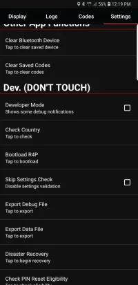

Where is the option located? I couldnt find anything in the menus.
So if the country is not USA it automatically deletes codes without having to check anything?
I would love to help you more but I have my primary cats so that's as much as I know. I looked into catless primaries and that's what I was told. You should be fine. I'm not sure what countries allow this bypass. I didnt go this route in the end. But if you dont want the check engine light there is a jb4 go around if you use a vpn (in the us). You however shouldnt need a vpn and are most likely good to go.
