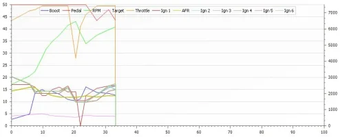

Log looks clean but log v8 firmware next so we see timing in cyl 2-6. That is normally a better indicator of how octane is looking for the boost levels. :)
New and improved, now with firmware 8 and IGN 2-6 data. Just a little roll on again :)

Even though I'm no expert, it looks like a very neat log to me.
my concern was the ign2-6 going to 0, but I was assuming that was during a shift. Wanted to make sure I was correct.

Looks good but really short run. :)

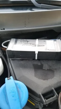

Just went through an automated car wash. Opened up my hood to clean up my engine bay a bit and discovered this. I am going to assume that it's this wet and soapy everytime I go through one. Should I be worried? Is there a weather stripping loose?

Looks like wheel or trans spin there on RPM jumping up post shift at higher RPM. I'd use the IAT wire to spoof up IAT so the ECU is running a higher boost target in that area. A setting of 6cyl=30 should do it.
The IAT wire is 1/2 of a fuel wire kit, a wire with a 1k resistor and posi-tap, that attaches to the JB4 brown MAP connector, allowing the JB4 to manipulate how the ECU reads intake temperatures. In this case you'd use that wire and related settings to make IAT higher and thus increase the ECU's boost target, and the trans holding power.
Alternatively just lower the boost target by lowering the map8 boost additive as needed for clean runs.

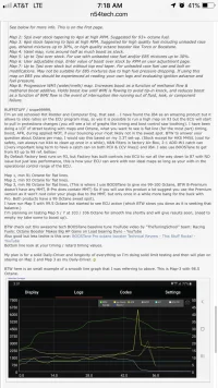

Terry has answered this many times before and the guidelines are listed on the first page of the N54 Kia/Hyundai page here.Kia & Hyundai JB4 - N54Tech.com - International Turbo Racing Discussion
Also there is a great technical breakdown by someone that tried different octanes at each map level to see what worked best. I’m not sure what page it’s on but here is a screenshot of the info which includes BMSs guide at the top too.:thumbup:974ECC55-E9AB-4B39-8F63-41A5E1CED59C.webpBottom line, you need about 96 octane to run map3 at full timing advance. Anything lower will have the ECU pull timing to protect from pre-detonation, and it won’t feel nearly as powerful.
Hope that helps and happy tuning!:D

Also there is a great technical breakdown by someone that tried different octanes at each map level to see what worked best. I’m not sure what page it’s on but here is a screenshot of the info which includes BMSs guide at the top too.:thumbup:View attachment 23501Bottom line, you need about 96 octane to run map3 at full timing advance. Anything lower will have the ECU pull timing to protect from pre-detonation, and it won’t feel nearly as powerful.
(facepalm :oops:) It does, and your post reminded me of why I specifically bought some Boostane (and a convenient funnel and small fuel bottle...) to meet that 96 or better requirement - I'm pretty sure i did read that previously. Must be the CRS Syndrome taking hold again. Thanks!
