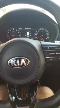

Went to Kia today. I'm going back in the morning to have the alignment checked, but today they "polished" the rotors. I asked multiple times why do they need to be polished at 6.5k km but didn't get a straight answer. I talked with the manager and of course he doesn't know either. I asked him for the serial number for the breakpads and he said he will check. He did not give it to me before I left so I'm going to remind him tomorrow. When I left and got on the highway I saw this ...20181223_162152.webp
Aside from the atrocity of cheap labor in a 3rd world country that has caused my wheels to be scratched and inflated with more air than max capacity. I was assured that the resurfacing was more like taking sandpaper to the rotor to remove foreign debris. I'm sure the issue will reoccur as the symptom was remedied and the cause was not addressed. When that time comes I will be sure to go straight to Kia headquarters for the Middle East. I didn't push the issue at this time because I believe in giving every individual rope to hang themselves with. Otherwise you just come off as a dick.
Went to Kia today. I'm going back in the morning to have the alignment checked, but today they "polished" the rotors. I asked multiple times why do they need to be polished at 6.5k km but didn't get a straight answer. I talked with the manager and of course he doesn't know either. I asked him for the serial number for the breakpads and he said he will check. He did not give it to me before I left so I'm going to remind him tomorrow. When I left and got on the highway I saw this ...View attachment 17019
You've been driving with over inflated tyres that long? To my eye it looks like factory psi (all above 50, as far as I can tell), with three out of the four tires (tyres) losing air at the same rate, and only one being "stubborn". :D
Lol No, I came with all tires at or around 42psi. Max load on tires is 51psi. That picture was when the tires were cold.
How do tires inflate themselves?? When my TPMS reading is cold it is always two to three lbs under actual. And here it looks like yours are four to ten lbs above cold. Er what? o_O
