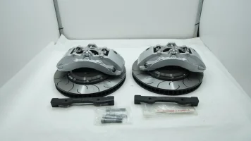

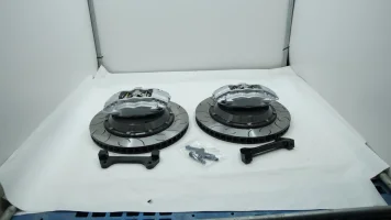

got these pics from my local dealer a few moments ago. Custom color caliper and alloy hub, can't wait until they arrive in a couple of weeks.

Wow...those look great. Those are Brembos right?
They are made by Neotech from Korea, everything is their own design with exception to the rear caliper which is a Brembo 4P from the CTS-V. The front is their own design 6P caliper but uses the same pad size from the 6P CTS-V Brembo caliper, by doing this they keep the options open for any pad replacement down the line. The rotor size is 380mm front and 370 rear, forgot the thickness but will make a separate post once everything arrives.
Haven't read any reviews etc before buying this, so I am taking a risk and one for the team. However my local dealer says they are very professional and has done his research and says they have a very good rep in Korea.

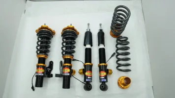

This is on the way too.

how much and where?
네오테크 on Instagram: “#첫줄 스팅어 . 네오테크 펜타존 서스펜션 PTZ-CK-DAILY00001 데일리용 NVH마운트적용 18단 감쇠력 차고조절 가능합니다 F_네오테크 6P브레이크 세트 R_CTS-V 4P 브레이크 세트 . 펜타존 세팅으로 제작되는 서스펜션은 조건(중량,…”
I got the parts directly from Neotech through a local dealer but I am sure you can get them from sharkracing.com as they have Neotech springs listed on their website.
Coilovers costed USD 2,300 with canceller, front 6P kit USD 2,200 and rear 4P kit USD 1,900. All prices without shipping.
