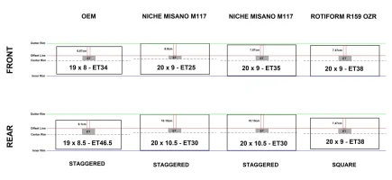

Ok so after some researches on my own, I think I understand now all these numbers.
Below is a quick drawing I did to visualy compare the difference between OEM and the 2 models shared before.
The drawing is just for the rims comparison, not with tires.
For the professionals please confirm if this make sense :thumbup:
Glad you figured out the definition of the offset. It can be very confusing at the beginning but after you have it sorted out. You can calculate the best spec to fit your car.
I recommend the following spec for your GT:
Niche Misano : 20x9 ET 35 Front and Rear with 255/35R20 Tires
Niche Misano : 20x9 ET 35 Front and 20x10 ET40 Rear with 255/35R20 285/30R20
Rotifrom OZR : 20x9 ET 38 Front and Rear with 255/35R20 Tires
Feel free to dm me if you have any other questions! The Misano and OZR are both in stock, if you would like to a quote, don't hesitate to reach out for the special member deals :)
Eddie @ GYW
Here is something that will help you visualize the offsets:
