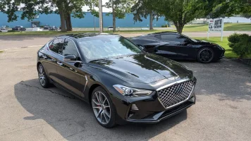

Followup on my wheel decision from earlier:
Need fitment advice. These Apex VS-5RS are by far my favorite wheels for a bunch of reasons: face design, weight, concavity, 1/2 off replacements (because potholes). But the manufacturer is small (also responsive to questions) and produces their 5x114.3 wheels for mustangs and so doesn't know how they fit on this platform. I'm an AWD G70 if that matters.
I'd like to keep 19" if possible but I'd do 20" if it means they'll fit. Here's their production/timing estimates for the various sizes. Would 20x9.5 ET35 fit in front? And 20x11.5" ET52 in back?
Apex did some digging for me and didn't recommend any of these options in the front. They don't have a buyback program if the wheels didn't fit and couldn't guarantee fitment if I didn't drop by their shop in the bay area. I'd seen they offer the EC-7 in 19x9et34, which they did recommend. According to the post I should be fine clearing the struts, as he has 163mm backspacing while the EC-7 should have 161. Next question is whether I go for black or anthracite
Go with anthracite so you can actually see the wheels.
Definitely an advantage for the antricite. Only concern is they have a slight huge that doesn't match a chrome-on-black G70. The black would match, but yeah they're flat black. Kinda boring

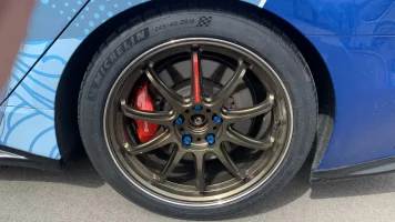

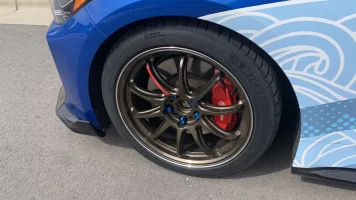

Finally found some wheels I'm satisfied with after a decent amount of trial and error.
They're 18x8.5 +38 with 245/40R18 squared. My car's lowered on Eibachs. The offset was just slightly too high so I had to grind down the part of the strut... It doesn't sit completely flush so I might throw on some spacers.
I think the highest offset you can run on 8.5s would probably be +35 but I'd say +30 would get you flush. Just too lazy to change out the bolts on the wheel hub and spacers suck anyways.
Yep, no problems at 35 but it's tight and I wouldn't recommend more.

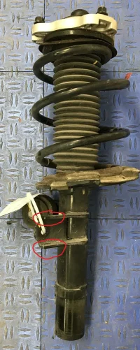

Any info on where you had to grind? Also nice choice on works
I shaved off those two uhhh... shelves (not sure what they're called) down. The bottom was the main area of concern but I did the top one for good measure. Didn't have to take off much at all. Thanks on the compliment! Super excited for them.

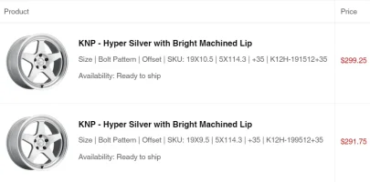

Anyone know if this would fit or would it poke too much and hit fender? On stock suspension currently.
Front 19x9.5 +35 255/35/19
Rear 19x10.5 +35 295/30/19
