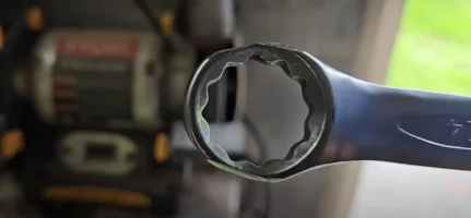

Hopefully anyone getting the oil pressure sensor replaced, their mechanics are aware of the shortcut, by gently modifying a 24 mm box and wrench.
I would not advise anyone pay the dealer to replace the oil pressure sensor. It's not really a difficult job. Basically, any mechanic who can do mechanicking, can relatively simply replace this sensor in just a few hours, time stamp video below, I think this video shows the entire procedure to replace it.
There is no need to spend all that time draining the cooling system and removing the main coolant pipe that runs through the center of the V in the engine.
