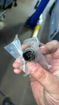

So I just got my oil sensor replaced at about 150,000km but the light still goes on. How screwed am I? Is the next step to disassemble again and try replacing the oil pump? How much more work would that be compared to the sensor? I’m very saddened by this outcome since it’s going to cost me thousands.

Is the oil pressure out of spec?
Did someone replace the oil pressure switch without diagnosing first?

They replaced it first without testing because sensor is probably bad then retested with new one and got <15psi of oil pressure at operating temps.

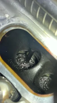

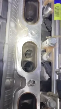

Update: oil light went away from sitting for a day and running a while. We presume it was the car adapting itself to the sensor and oil pressure again. Also got my valves walnut blasted while the engine was apart.

Yeah, if it wasn't clearing immediately after replacement, I'll bet it just took a bit to reset after getting the appropriate readings. Those valves looked nasty. Do you have an OCC installed?
DIY walnut blasting...
3/4 Of the challenge is just everything out to gain access to the ports.
That was the worst ones, the rest wasn’t nearly as bad. No OCC installed, probably not gonna bother with one since I’ll be trading in for an EV in the next year or so.
