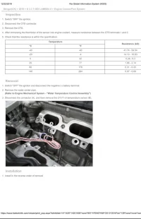

D.J. do you have a diagram showing the resistance of the oil pressure sensor?
Kinda... But it only gives the resistance vs temperature, not pressure.

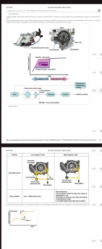

I attached the description of our oil pump as well. It's Interesting.

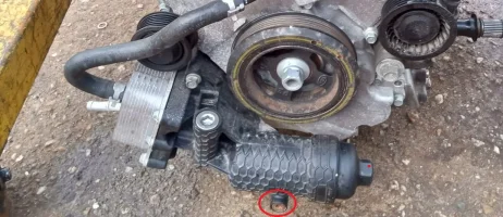

My first thought is to use the plug in the oil filter housing:
As you can see, it is a screw with a gasket, so there is probably oil there. I don't know how reliable this measurement will be.
View attachment 88064View attachment 88065
If you can thread an oil pressure gauge into that port, that should be perfect, and should give you a valid oil pressure reading.

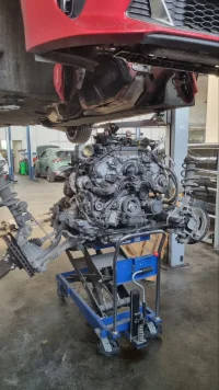

Got this thing (oil pressure low lamp) on and off at idle a month ago. Drove the car directly at the dealership the next day and haven't seen it since then... They changed the oil pressure sensor - no effect. Just got a call that the engine and transmission are out of the car, there were chips in the oil pan and that they are disassembling the engine... So sad and disappointed, really. The thing didn't have 120k km on it, at least we have 7y warranty here and (hopefully) the repairs are covered by it, but...damn... Another dream in the trash...
Are you proceeding with the repairs with only a hope that it will be covered under warranty?
This could be very very costly
It is covered, but they can always come up with a reason later why it could be my fault (once they figure out the real issue).
Well, good luck, hope it goes smoothly, keep us updated as best you can.

My engine is OK, at least for now. The issue seems to be the oil pump. Will be replaced under warranty in two weeks, along with some minor oil leak.2.webp
My engine is OK, at least for now. The issue seems to be the oil pump. Will be replaced under warranty in two weeks, along with some minor oil leak.View attachment 88592
Wow, this is the first defective oil pump I have read about. That would be a significant fear of mine!
Actually, owning such a complex car is a significant fear of mine. But I live with it and don't borrow trouble from the future. Our own bodies are far more complex than any vehicle will ever be, and we don't go around getting all worked up over what system might fail next. Well, we don't if we are not mentally ill.
With the variable vane pump our cars use for an oil pump, I don't think it is as common on vehicles to use this style of pump.
She's back home from the ER. :D Oil pump changed, oil pressure sensor changed, oil line (recall) changed as well as various gaskets required when disassembling the engine. So far so good, nothing scary on the dashboard and they'll check from leaks/issues next month.kola.webp
