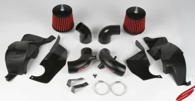

Is there a cutout in front of the enclosures to allow air in from the air ducts or is the plastic wrapped completely around the filters?
There is nothing on Facebook to see that isn't here in this thread. Just a vendor posted the same pictures that were posted here on our FB group.
Do you have pictures of the components, uninstalled, that you can share?
Thanks for the pics @STILLEN .
Is your cutout located in a place where it will draw in fresh air from the car's stock ductwork? (I can't make it out in the pic, honestly)
Also, what size is the tubing?
No worries! Yes, we need to get better pictures of it, but the stock bumper intake ducts guide air DIRECTLY into each air filter enclosure
Awesome, thanks a bunch!
Thanks for providing the additional information.
In the video, it looks like the tops of exposed red filters are seen. Were the dyno results obtained with or without the filter enclosures? Which provided better performance - the oiled or the dry filters?
Wow, good eye dude.
They do appear to not have the enclosures on.
Wow, good eye dude.
I guess I can justify that 42" 4K monitor now ... :p
It's great to finally get some information on the finished product - I've been watching this with interest since they originally posted. Next question for @STILLEN - what is the material used on the tubing? Anodized or powder coated aluminum? Or a plastic/composite material?
  • No measurable difference in HP figures with dry vs. oiled filters
  • Dyno tested with and without enclosures: no horsepower drop with enclosures installed, enclosures smoke tested to ensure proper utilization of airflow from OE intake ducts
  • Black powder-coated aluminum tubing
Good stuff! Thanks for the additional information ... looks like you have a nice product there. :thumbup:
Soooooo....resident pest here again...
@STILLEN you guys have any pics of where the duct goes into the enclosure?
