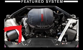

Yeah, and it's a pretty big gap too. See photo below.

Considering the gap shown in the photo above and the fact that the Stinger intake ducts are not passive (not sure if that's the right term), meaning that air does not flow into the intake when the car is moving, since it's not in a direct path of air flow from the front grill (like on the G37's and 370 Z's), I dont see how this intake will take advantge of the factory ducts, as the filters will need to be completely sealed and the boxes need to be directly attached to the factory tubes seen in the engine bay (like the OEM intake boxes) so that air is directly sucked in through the ducts.
As a matter of fact the factory ducts on the Stinger are located away from the grill, the sit below the radiator air guide and right above the radiator air duct. Completely away from any moving cold air in the front going into the engine bay. See photo below (Don't know why KIA designed it that way though)
The gap is so large because the sides of the radiator shroud aren't installed.
But I agree about the ducts like. I'm really interested to see how the Stillen boxes use them since both Stillen and Khar have said they are in fact used to bring fresh air in. I'm still a bit skeptical since I can't see them in the pics of the installed intake and the the pics of the intake parts don't look to have any cutouts for the ducts to pipe into.

The turbos need to be blocked from the filter. The sides and rear of the filter in the KIA are the most critical sides that need blocking. Blocking the top and front is pointless imo.
The top area can just use a simple peice of weatherstrip and compresses agaisnt the hood. Easy. heres a mock up of the stillen picture.
If they can achieve a complete seal of the area and locations marked in red, I will def. try it out.intake-announcement-stinger-gt-final_02.webp

So I was looking at my JT intakes earlier, and was going to put the boxes around the filters that it came with finally... then it hit me....
If they can achieve a complete seal of the area and locations marked in red, I will def. try it out.View attachment 10934
That part is sealed. My understanding is that the only opening is the one you see on the top near the side of the car.

The factory ducts are well designed. G37/350z's are na motors with a relatively low vacuum at the intake. Ram air type snorkels help push more air into the motor at speed, downside is more dirt on the filter and potentially risk of water if you drive in very wet areas. Kia Factory intake snorkels suck air directly from the cool incoming air that passes just below the top radiator shroud cover. Seeing the shroud design behind the bumper cover, Im quite impressed with the factory ducting around the airflow for the radiator, intercooler and through the engine bay. (still wish they left off the fake hood scoop or made them functional.)
That being said, there will be flow from the snokles as long as the car is moving. The cut out should also be drawing air from cool airflow going through the engine bay when the car is moving, but no way to confirm until someone installs this and or we get some more detailed pictures.
Seems the Stillen intake needs this JT modification. If the box was fully sealed it should act like a stock airbox with a high flow filter. I suspect it does pull extra air from the gaps. I also trust their dynos, the 343 hp stock on a dyno jet is spot on. I'm very suspect of other vendors that show 365 hp stock and take credit for the 20hp under rating.

Honestly I'm hoping for the best. If Stillen can show a pic of their intake's box with a duct connecting to the stock location I'm going to buy this one.
If their wording about the fresh air duct ("the stock bumper intake ducts guide air DIRECTLY into each air filter enclosures") was just a salesman's play on words I'm going to go with JT. Stillen's words seem pretty definitive, though.

The basic problem with intake design is as you try to seal off the filter from "hot air" you inevitably end up increasing the flow restriction of the intake system reducing performance. The best functioning systems duct air from the front as much as possible, resist radiant engine bay heat, and allow the turbo to suck in as much air as it needs with minimal restriction. The higher the power levels the more power is lost due to turbo inlet restrictions.
