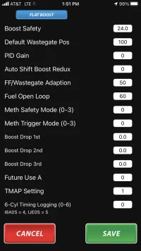

I recently took a 1300 mile road trip in my G70 that has his 1.5 93 octane tune and level 3 TCU tune. I'm still waiting to receive the AWD tune, as it's in transit. 800+ miles of this trip was on two lane twisty roads, which is how I enjoy driving the car the most. I'm not a drag racer or street racer, but I love a great handling/fast car. For the kind of driving I was doing, I was not happy with the setup as is. I think it could be better, and I do plan to send the ECU back to him for some adjustments. My issue is, as I've shown him via a few logs, my "boost" is like an ON/OFF switch. It's either almost nothing, or 20lbs, and no in-between, with the smallest of throttle inputs. This isn't good in a 25MPH switch back curve, applying a little throttle to power out, and BAM 20lbs of boost! If not for traction control, my car would be in a ditch right now. If it can't get better than it is, I'll go back to stock, or just use a JB4.

I agree it goes all or nothing. If you still have your jb4 you can run map6 add target boost 0. And if you want disable everything else. And turn FF adaption down from 50 it will slow your spool speed down and act more like stock if you want.

Yes it also helped when I turned it to linear pedal mapping as well. It can get pretty wild especially if your driving some where and hit a cooler air spot while you getting on it.

But do you need EWG for that to work? Some people might not have it.

I do believe so. But for me it was alot better waiting 2 or 3 days on bms to ship then around a month for a refresh. And at the track I want it's crazy spool speed. It's also helps being able to choke ewg down of you have down pipes and the temp drops. If it's a hot summer track day you will want to run all disabled. If it's in the spring or fall you will be glad you have ewg wires.

So what numbers should I change? I don’t have ewg wires.
