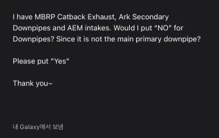

I mean for the “exhaust downpipe installed” yes or no. I have the stock primary, catless secondaries and catback. No plans on changing any of that either.
So I asked them the same thing and they said yes. I feel unsure tbh. Lol
True, I was curious because I read conflicting answers. Rob has the same exhaust setup as me and he said he put no. I’ll likely just put yes along with open air filter.
I said I think I put no, couldn't find order form and couldn't remember questioning.
I understand, I’ll just go with what they have told everyone as of recently.
