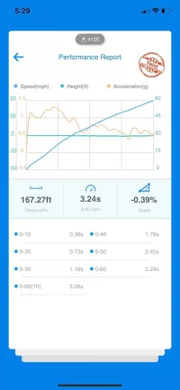

Lozic ECU + TCU + AWD Tune
0-60 wasn't even at full potential. Literally just a daily driven full interior'd car with a full tank of gas, dropped my daughter off to school. It will do 3.1 or lower when prepped to try and run faster. (my track wheels/tires, weight reduction, remove spare tires/golf clubs etc)
Before this week, I ran JB4 with CPI and full bolt ons. Nothing crazy. Just full bolt ons with JB4 and CPI. For what it was, the car was freaking insane and was plenty fast and safe. "same boost" means nothing. I run lower boost now with the LAP3 ECU and the car is more powerful and faster than it has ever been.
Boost is not everything to make more power and run faster times. There are so many other factors in a "tune" that take place when it comes to "tuning". Love BMS, love thir products, but JB4 only adjusts so much when it comes to tuning.
I still use JB4 because it essential and a must for me to run LAP3 ECU without water/methnaol. Again, I run BMS charge pipe injection without methanol on an ECU tune which no one has tried. So JB4 still plays a role on my setup and I wouldn't be able to run it with out it. Unless, i ran water/methanol set up.

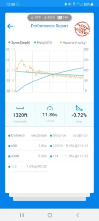

I'm very happy with the results from my Lozic ECU on this cool autumn night here in Indiana. Turbo weather has returned. I wonder how much faster my times will be once I install the TCU??? The ECU has been installed for over one week now and every day it seems to adapt more. Fuel used was 13 gal of 93 plus 3 gal of E85. Roughly a E24 mixture. The Lozic ECU seems to like the fuel mixture I'm using.Screenshot_20211018-005851_dragy.jpg
