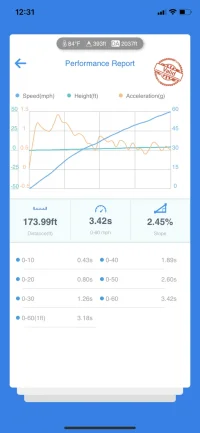

Full weight, 20-inch wheels, full tank of gas, no WMI. Complete daily driven set up. ( I run CPI on E40 to E50)

0-60 wasn't even at full potential. Literally just a daily driven full interior'd car with a full tank of gas, dropped my daughter off to school. It will do 3.1 or lower when prepped to try and run faster. (my track wheels/tires, weight reduction, remove spare tires/golf clubs etc)
Before this week, I ran JB4 with CPI and full bolt ons. Nothing crazy. Just full bolt ons with JB4 and CPI. For what it was, the car was freaking insane and was plenty fast and safe. "same boost" means nothing. I run lower boost now with the LAP3 ECU and the car is more powerful and faster than it has ever been.
Boost is not everything to make more power and run faster times. There are so many other factors in a "tune" that take place when it comes to "tuning". Love BMS, love thir products, but JB4 only adjusts so much when it comes to tuning.
